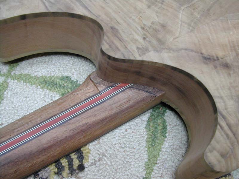

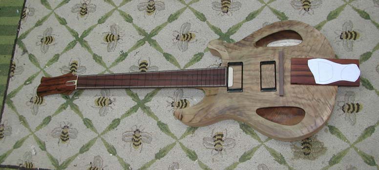

Hey All,
I wanted to post some pics pf the all koa archtop electric I have been
working on. I'm about ready to start binding the body and then fine-tune
the re-curve at the edges.
Cheers,
Louis

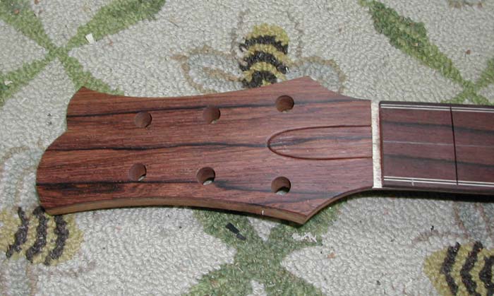

Louis
What's the deal on the truss rod adjustment cover? Looks like you cut it out and then glued back in place temporarily for finishing.
Very nice!
Nelson
PostPosted: Wed Nov 01, 2006 4:37 pm
Louis, that is one slick looking axe
The truss rod cover looks really great! It looks like you cut the truss rod cover out of the headstock overlay, then laminated on the overlay?

Thanks all. I cut the truss rod cover from the overlay before I glued it to the
peg head. In the end it will be secured with a screw, it's just resting in the
pocket for the picture.
I’m trying to do a similar thing with the sound hole cut outs to see if I can
use them as plugs. They may end up with bindings. I'm not sure about the
sound holes yet. If I had a grammel I might try violin style purflings around
them.......

Very nice Louis! I like the design a lot.
PostPosted: Thu Nov 02, 2006 2:01 am
Joined: Fri Dec 16, 2005 1:47 am
Posts: 504
Needs a sunburst.
Just kidding, that is sweet. The body and headstock
shapes, soundholes, all of it result in a really
cohesive design.
I would think about not binding it. A nice round-over
on the top and back would give it a cool
homogenous look to it.Mike Dotson39023.4185185185

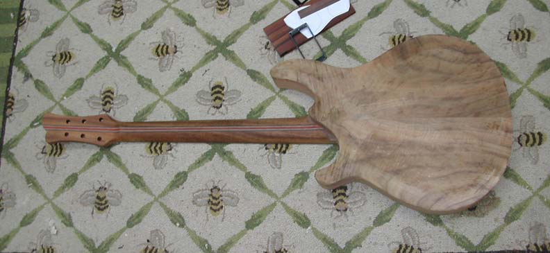

What did you do on the inside structure?
Is it all hollow or do you have support at the bridge?
Any pics?

I forget to mention in my previous post: another step in preparing the
peg head veneer for the flush mount rod cover is to bevel the edge where
it
touches the nut before you cut the truss rod cover out. I've been thinking
I
should photo document this process on the next neck and post it for
posterity.
Thanks again for the encoutragement!
Louis
